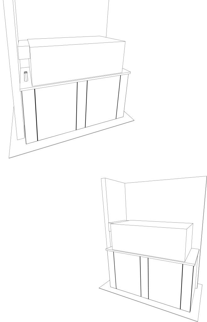

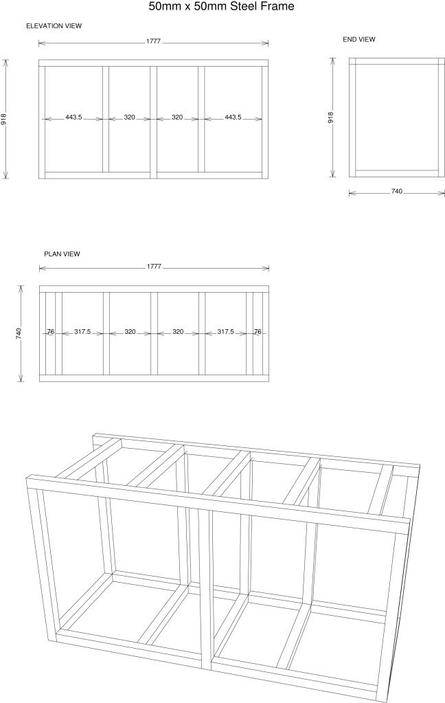

Hey guys after having a 3x2x2 for the last few years and settling into a new house i have finally taken the plunge to get a new tank, do this perfect and hopefully keep for a very long time. Very much inspired by Rodneyri's tank i have tried to go with a tank and cabinet that are both visually stunning and hopefully very natural to look at (ie minimal cable vision)
it will be going in the same place the current 3x2x2 tank is and details are as follows
tank size : 1525x750x550 (custom built by Aquaristic) with over flow laser cut out on left hand side of tank
Bean animal overflow
Stand will be built out of 50x50 gal tubing 2.5mm thick. should be a nice strong bugger. frame will then be clad with poly doors and top with tank sitting in the centre of what will be a 6ft stand.
Sump still yet to be determined. i will finalise sizing of sump once i receive stand and get a good gauge of how i set it up.
all current gear and equipment from 3x2x2 will be used for the new tank which will include :
deltec ap801 skimmer.
kamoer dosing pumps
vortech mp40
inwatter led lighting system ( will need to work out additional lighting)
planning on a nice low open rock look to the tank which is very popular at the moment amongst reef keepers and something i love.
strike up date will be end of january. i will have tank and stand in next 2 weeks but unfortunately i will be delayed getting the poly cabinets done as they are flat out and then will be taking time off over xmas.
anyway enough with the blubbering here are some of the plans that have been drawn up for the new setup. any ideas and critisms are more than welcome as i want to get this perfect. a great deal of thought has gone into this.
will post a pic of the current setup and wall area it will be going on shortly
Cheers Kell :)

cool Kell, how are you hiding that weir?

im planning on leaving it as is and painting the plumbing but if i dont like the look of it i plan to cover it with come black perspex or something.
