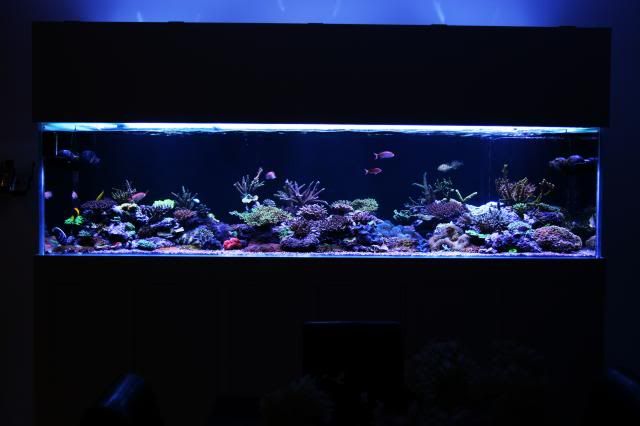

FTS 23 May 2013

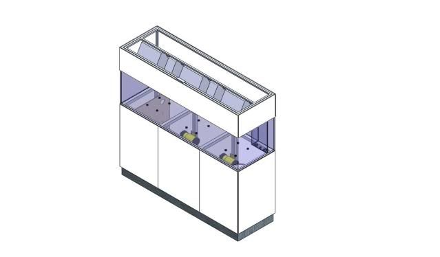

Tank

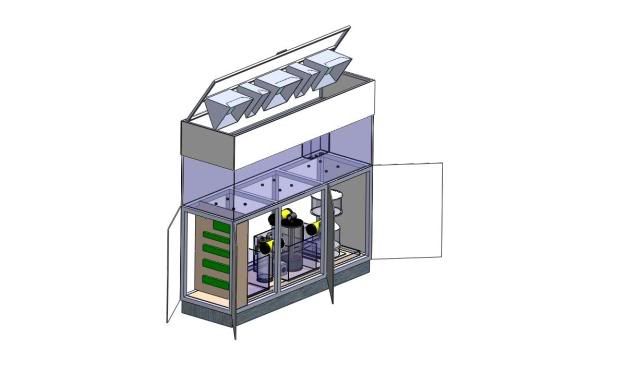

Tank & Sump

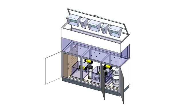

Tank with doors opened
Over the last few months of planning and purchasing my tank arrives on Tuesday. I hope you follow along.

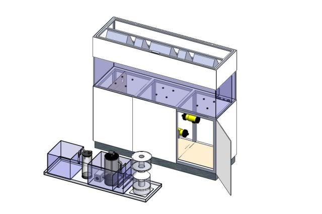

FLOW
I decided to use a Gyre flow closed loop, based on Rod the Reefers (thanks again for all your help, Rod). The pumps I chose were 4 x PanWorld 250PS-MD100R External Water Pump 7200LPH with 8 x Flow accelerators (Flow x 400%). These are the biggest in the Panworld Range, I've heard a smaller version live in action, and they are very quiet. Amazing how big and heavy these beast are though.
Each pump will feed 2 outlets. I've designed the output holes in the display tank and the placement of the each pump (mounted on the stand), so that each output has the identical length and elbows of plumping, so that each output has a same amount of flow coming out.
2 pumps will run simultaneously, then flick off by timers. The other 2 pumps will then turn on, changing the current in the opposite direction. Creating a whirpool effect. I'll consider a storm period where all pumps are on simultaneously. But I'll be taking a "wait and see" approach to this, as I fear for the paint of my ceilings should things get too wild.
I've killed too many corals over the years by placing them directly into the flow, so with the use of the "flow accelerators" i'll be pointing the flow of each output, angled into the glass as discribed in the flow pattern diagram below.
Closed Loop Holes
Flow Diagram
Pumps
Thanks for reading. Stay tuned ....

This is gonna be insane, subscribed!! Awesome work with CAD aswell.
