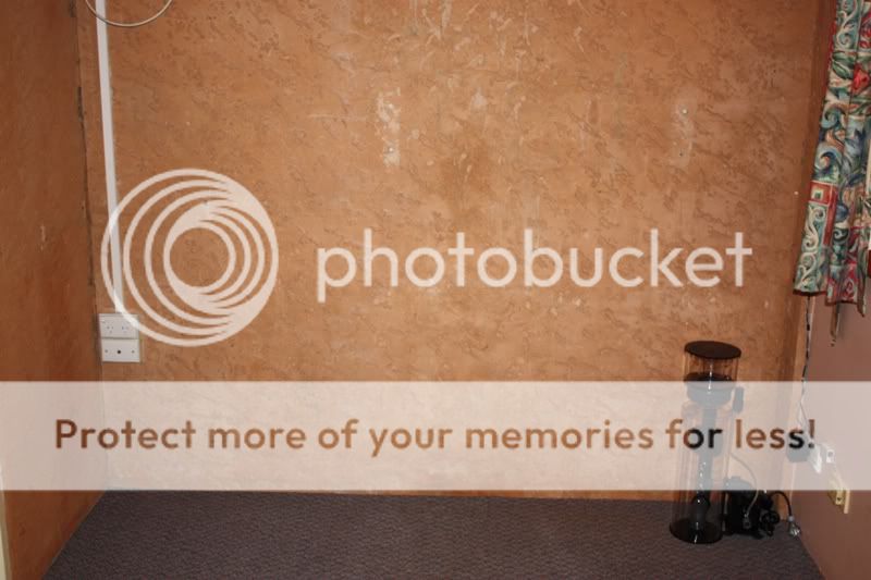

Where the tank will sit

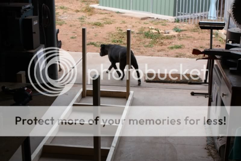

Starting the frame with Pepper walking away in disgust as Im not paying attention to her
More work on frame

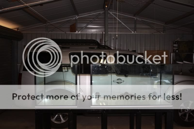

How the DT & Quarantine tank will sit on the Cabinet

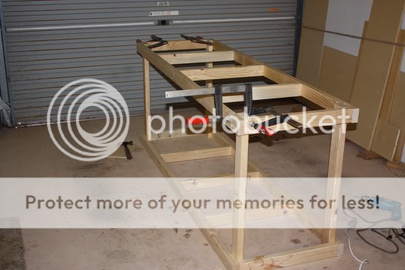

Framework in place as I have to finish it here
