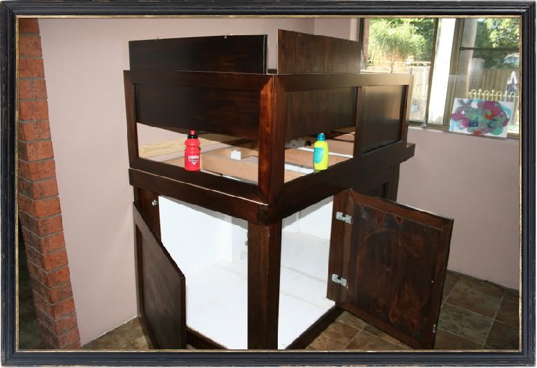

Postby Alf D » Mon 09 Mar, 2009 8:10 pm
Stand built from mostly 90 x 42 Meranti

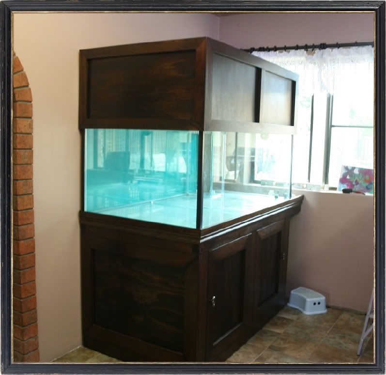

Postby Alf D » Mon 09 Mar, 2009 8:19 pm
Nearly finished, just needs the top and bottom decorative strips to hide the tank bottom.
The tank and sump should be here in a few days :)

Postby Alf D » Thu 12 Mar, 2009 4:46 pm
Next job is to do the plumbing.
Was quoted for 10mm thick glass but they did it in 12mm at no extra cost :clap:

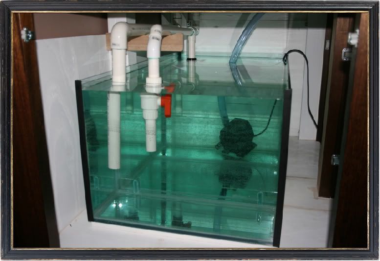

Postby Alf D » Thu 12 Mar, 2009 4:48 pm
The sump.

Postby Zeason99 » Thu 12 Mar, 2009 5:06 pm
Alf_D wrote:Nearly finished, just needs the top and bottom decorative strips to hide the tank bottom.
Your grandson's little water bottles did come in handy hey... :roflmao: :roflmao:
Very nice stand by the way. Can't wait to see the whole tank fill up with SPS!!!

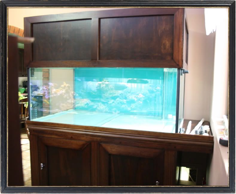

Postby Alf D » Sun 15 Mar, 2009 11:57 am
Leak test :thumbsup:
Power failure test :thumbsup:...with 25mm to spare

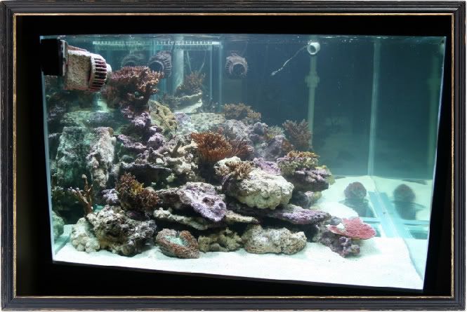

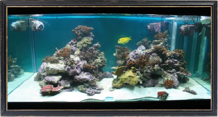

Postby Alf D » Fri 20 Mar, 2009 7:55 pm
Almost done, just need to build up the left rear and glue the frags on and hope the Acro's colour up again.

Postby Alf D » Fri 20 Mar, 2009 8:03 pm
From the side. Water hasn't completely cleared yet.
