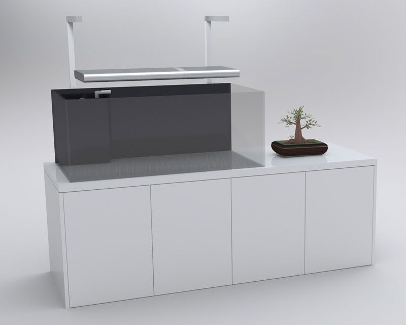

Images:
new tank is in progress...this is the design

Hi there i love your tank and stand, looks great. I have a question about your overflow, do you use any egg crate at the top or does the water fall over the top of the glass into it? Also are the three holes all drilled at the same height? Thanks Troy
ps can we have some update pics
