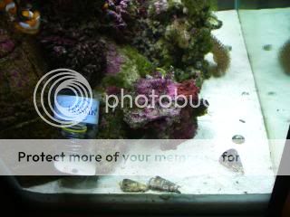

Hooked up the float valve this weekend and seems to be working really well, in the two fresh water sections of my tank, it can holds about 50l so hopefully won't need to check the level of the water in my sump for evaporation everyday.
a month later... a lot of green hair alage which I am manually removing until I get some fish\snails that
will eat it and also lots of colour on the live rocks. Getting all sorts of small shrimps coming out at night.
