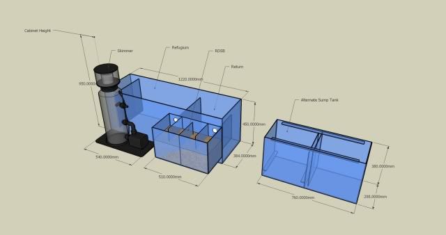

Postby Jamess » Sun 14 Feb, 2010 1:18 pm
This is a rough plan of what I'm considering for the sump. I was originally planning to use the tank labeled as the alternate sump tank, but at 2.5 ft the size was restricting. Ultimately I'd like to have a cabinet that's ~5ft long, but my wife won't let me (DT is 4ft).
I like the idea of having a separate DSB because it frees up space in the sump for a huge 'fuge and good size return section as well. With the 2.5ft tank as a sump I run the risk of a flood with power out, due to a small return, or I will have a little fuge (but I want a big one).
Skimmer to be gravity fed from DT, with some flow from DT going directly to the small pre-fuge/skimmer return section in the sump (can't see it really in the pic). Water then runs along the bottom of the sump, up through egg crate (not pictured) which will support the fuge (live rock and macro). Water then runs through a bulkhead to the RDSB, then back through into the sump, with piping taking it to the bottom of the sump. Small bubble trap next, and then the return pump, which will T off to a chiller. Not sure if the chiller out will recycle back into the sump, or go directly to the DT.
I've never done anything like this before, so be nice if this is a stupid design for some reason :cheers:
P.s. sorry for the small pic - photobucket shrunk it and I didn't bother changing it.

Postby imf » Fri 19 Feb, 2010 9:57 am
Hey James,
Just throwing an eye over the sump plan. Just make sure that you don't make the back sump too difficult to access. I can picture difficulty trying to get behind the skimmer to harvest macro or do sump maintenance.

Re: James' 4x2x2 - newbie tank with T5s
Postby Jamess » Fri 19 Feb, 2010 10:20 am
Good suggestion, Ben. I'd actually given it a little bit of thought and was considering having the skimmer plumbed with flexible hose and sitting it on a secure base that's attached to the cabinet door. That way when I open the door to access the sump, the skimmer moves out of the way, giving access. It wouldn't be very complicated to implement at all (but obviously not ideal). I really wish I had more space under the tank without having to sacrifice the 4ft sump. I don't want to put the skimmer in the sump either... Something about wanting to have my cake and eat it as well..
