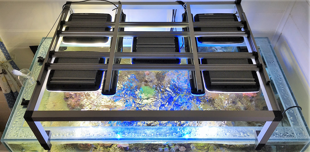

Display Lighting: AquaRay AquaBeam system with Controller. 2 x 1500 XG Ultima, 3 x 1000 HD Ultra, 2 x 600 Reef Blue. On AquaRay rack on DIY frame on tank rim.

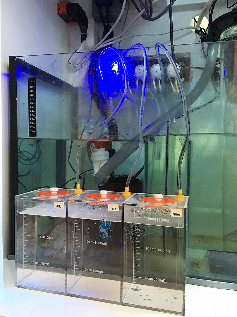

Evaporation Top Up: Auto topup – DIY with Williamson Peri Pump. Renovated PSI RO unit with new cartridges and filters.

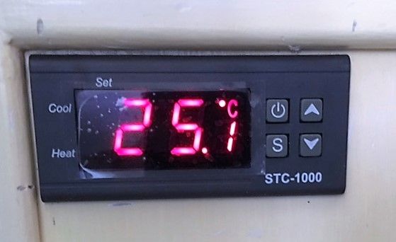

Controllers: STC-1000 for Temp. AquaRay for lighting. Jebao DP4 for dosing
Calcium Addition: Randy 2 part dosing via Jebao DP4
Alkilinity Addition: Randy 2 part dosing via Jebao DP4
Other Chemical Maintenance: Magnesium via Jebao DP4, BioPellets via FBF. Carbon on standby via FBF.

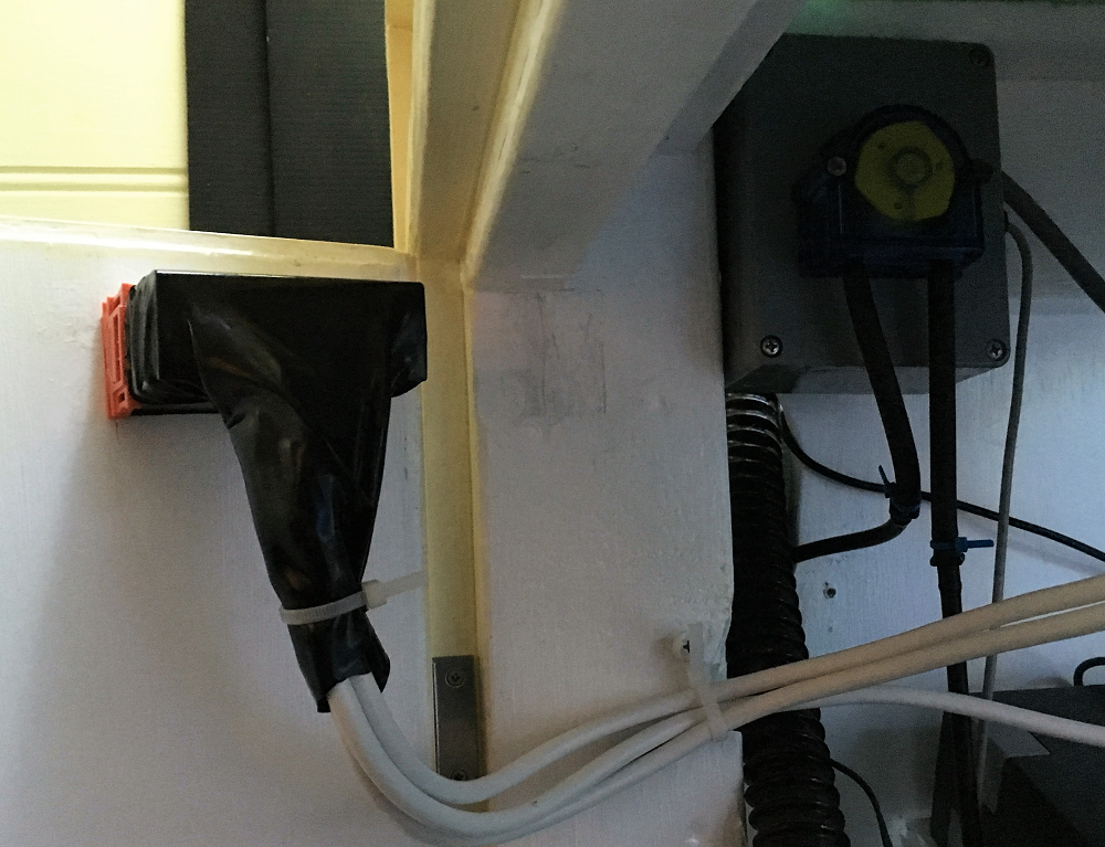

An old GB DIY multicontroller gives me control of lights, heaters, fans and timers for Alk & Ca pumps via 10 outlets and a Chauvet power rack gives on/off for 8 sockets.
First trick was to fit the old multicontroller, which were never very mount friendly.
I still get a kick outta what you can do with a strip of acrylic and some heat:
7134
A small ledge of wooden angle supports the weight of the multicontroller and the acylic bracket holds it in place.
The Chauvet is just screwed to couple of small blocks and fits pretty snug!

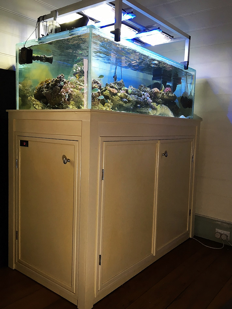

Well, I got pretty close to having the tank all setup and then life got in the way once again! Almost a year went by before the tank got wet. :konk:
My middle son Kieran’s impending 13th birthday seemed a good opportunity to pull my finger out. Added the acid washed dead rock and some very old live rock from my FOWLR, then filled it with NSW. After a week, added a 5kg piece of the freshest LR I could find at my LFS Reef River Reptile at Hornsby. Then I just fed the tank and let it cycle.

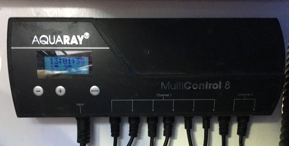

I’ve made a few changes to the original equipment list. Firstly, I ditched the old Group Buy Controller. Some of the relays were switching intermittently – must’ve been fritzed in the great flood when my big tank split years ago.
For temperature control, I’ve installed a simple STC-1000 in the end door of the stand. The tank is in my kids room, so I can check temp as I walk past their room. I’ve used some oversized shrinkwrap to waterproof the electricals and secured the cables with a drip loop. My DIY ATO (another old Group Buy item) is now located above the return section of the sump.

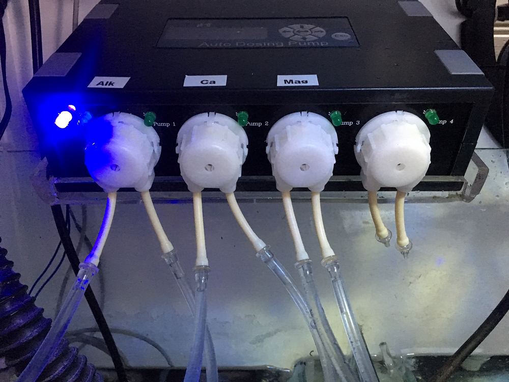

I’ve added a Jebao DP4 dosing controller and 3 section reservoir for Calcium, Alkalinity and Magnesium supplements. I was going to DIY all this, but the Jebao is such an affordable piece of kit, why bother. Only took a few minutes to calibrate and program. I’ll monitor and tweak over coming months, but I’m really happy with such an easy way to keep these parameters stable. DIY’d a tray from some 5mm perspex coz I’m cheap and enjoy mucking about heating up perspex. It's angled so I can see the screen to program without having to move it - easy!
When Dviv and Stoli shut down their beautiful big tank I picked up their AquaRay LED’s, some Ecotech MP40’s, and a Jebao RW40. Gotta like the flexibility of the rotating head on the Jebao, allows me to direct the flow where I need it, in this case a random flow into the return eductor/flow. Anyways, sorted my lighting and flow - thanks guys!
I’ve made an aluminium frame that sits on the tank rim for the AquaRays. It allows me to easily move them if needed for maintenance and eliminated the need to build a hood. I modded the AquaRay rack to hold the blue strip LEDs perpendicular with some alu angle. The rack can slide for and aft on my frame and the whole thing can slide left and right on the tank rim. It’s not the most minimalist look, but it’ll do for now. Nice to have a controller that does the whole sunrise/dusk/moonlight thang. A modded laptop charger on a timer controls the extra lights the controller can’t handle.
After a few weeks of idling away and throwing in a bit of food, I figured the tank was ready for livestock. There’d been no measurable ammonia spike (new Salifert kit) after adding the fresh LR – transferring old LR from my FOWLR meant a minimal cycle IMO. I picked up seven sml to med Blue Green Chromis (Chromis viridis), a handful of hermit crabs and a Lawnmower Blenny (Salariias fasciatus) from Mark of Aquariums @ Asquith to start with. Also bought a fat Coral Beauty Angelfish (Centropyge bispinosa) and an active looking juvenile Sailfin Tang (Zebrasoma veliferum) which both went into QT. Kieran enjoyed his birthday presents and was able to show off his fish and tank during a great party with 25 of his friends. He’s been really involved in feeding and testing and been a great help installing gear and getting everything setup – another reefer in the making!
With still no measurable Ammonia, we now added the Coral Beauty and Sailfin from QT.
