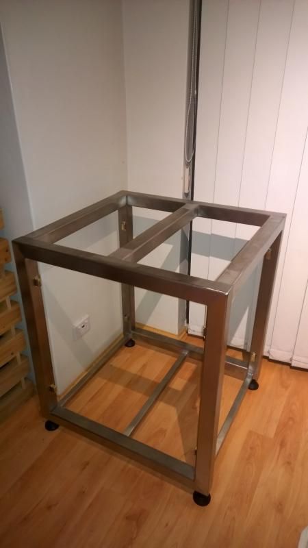

So far I've had the stand built, ill use magnetically attached panels so i can pull them all off for maintenance. the magnetic latches are attached to the inside. the stand was expensive but im really happy with the way its come up, worth every penny.
I've used 'Adjust-a-foot' feet as the floor isnt entirely level where the stand sits. there's a nut welded into the bottom of each stand and the feet screw in. the feet are load rated at 600KG and will only support about half that maximum
i'm re-using my old sump, no baffles except for the bubble trap on the intake, i thought about putting in baffles but prefer having maximum space available for equipment so my giant hands to get in for maintenance.
