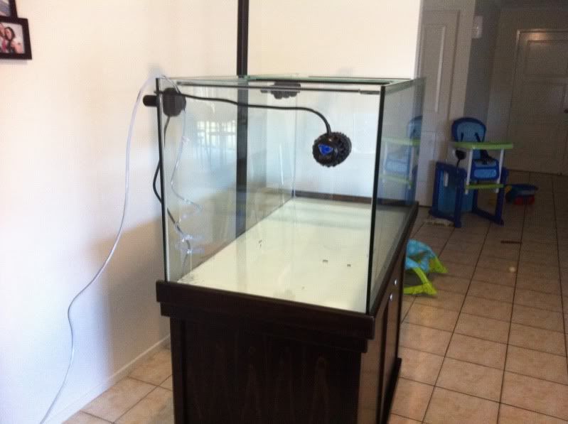

Postby ssbk23 » Mon 08 Aug, 2011 9:51 am

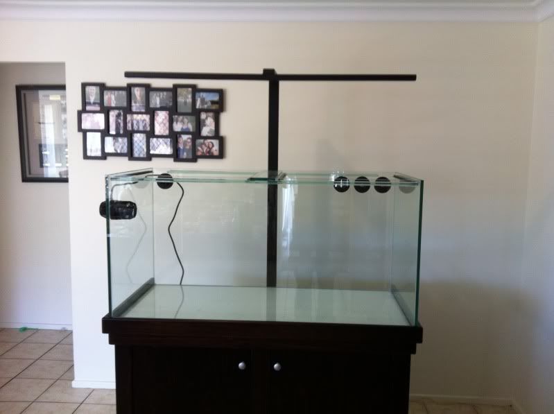

Got the tank on Friday, just waiting on the sump to arrive, should be end of this week :)
Tank and cabinet was built by G & J Mahor and the quality is superb :)
Here is a crappy iPhone pic, will take better ones when my camera has charged

Postby Phenom » Mon 08 Aug, 2011 1:34 pm
Tank and stand look good mate.
Not long until it will be wet with salty goodness.

Looks great mate...

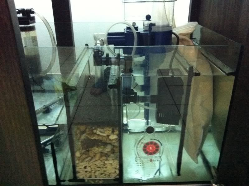

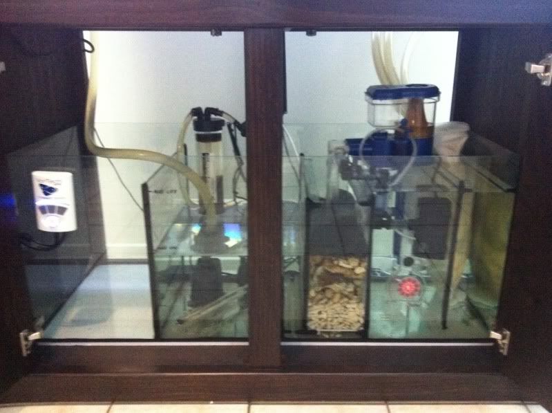

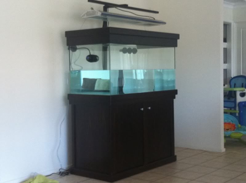

All up and running now!
Took me a while to fill. I run a hose from my RO/DI unit into the tank and filled it over the course of 3 days. Mixed the salt once it was full and running.
Turned on the lights and the blue actinics started to melt the acrylic covers so I'm getting a replacement and paying the extra to upgrade to 250w halides
Sump has 5 stages. First is the inlet that runs all 3 overflow hoses into a filter sock, that flows under a wall into the skimmer section. Skimmer section overflows into the bio section and has the skimmer outlet running into it too.
Bio section houses a mix of live rock and coral rubble with course foam to quieten down the overflow.
Bio section then runs down under a baffle into the return section which houses heater, return pump and phosban reactor.
5th section isn't set up yet but will be the refugium fed by the chiller I'm purchasing shortly. Refugium will have a sand bed with macro algae. This will overflow into the return section.
Got a black acrylic backing made up on Friday, definitely looks better than before imo.

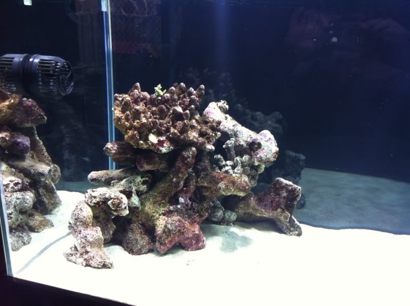

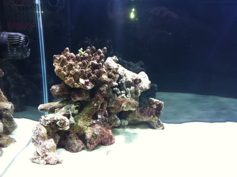

Tank has around 25kgs of rock in it now. The aquascaping kind of went to plan. Im planning on doing the same on the other side and have a valley in the middle. Possibly with a short mound by itself in the middle.
Let me know what you think! Would love further suggestions with the aquascaping. Let me know if you think it looks good so far :thumbsup:

Re: Shane's 4x2x2 SPS & LPS reef tank *UPDATE with pics!!*
Postby Macca_75 » Wed 31 Aug, 2011 4:15 pm
Hi Shane,
Can I suggest you move your Ecotech controller - would hate to see water slash onto it and ruin it.
I've also noticed you replaied to a seperate thread on wiers and how you don't run one - will be watching to see what happens when you start feeding the tank as it matures.
Looking good though - they look nice when they are all brand new :-)

Postby ssbk23 » Wed 31 Aug, 2011 4:39 pm
Thanks Macca,
Good idea about the controller. Not sure where else to put it at this stage, will have to sit down and think of somewhere else.
Would have been easier with some things if I had of had a backing on the cabinet.
So far so good with the skimming. When I added the live rock and then moved it all again I had a lot of crud floating around that got skimmed out rather quickly.

Postby Macca_75 » Wed 31 Aug, 2011 4:42 pm
Maybe you could mount it on the inside of the door?
Postby WarbyD » Sun 25 Sep, 2011 11:43 am
Out of curiosity mate, what have you made your light stand from? It looks like the aluminium connect-it tubing from Bunnings, but when I tried to hang my aqua medic 4' light from some of that I couldn't get it anywhere near strong enough to feel comfortable with it (I had it set up like two large "L" shapes coming up over the tank and had the inner angle of the "L" reinforced with shelving brackets - if that makes sense lol). Damned heavy lights they are :)
Looking good so far :thumbsup:

Postby ssbk23 » Sun 25 Sep, 2011 12:08 pm
Thanks mate :)
The light stand I designed myself and was built by the fabricator at my work.
It consists of 50x25mm box section steel with sections screwed into the bottom and top bracing of the cabinet.
There isn't any movement in the bracket with the weight of the light unit
You're right there is alot of weight in these units!

Yeah.... nice little dent in the quarter panel of my car from when I first tested my connect-it frame haha -- caught the light, but the frame kept going :P
Cheers for the info - really need to find myself someone local with a bit of welding skills to put something together for me :)

Postby ssbk23 » Thu 29 Dec, 2011 1:12 pm
I've been pretty slack with my tank journal, mainly because I haven't got a decent camera to take pics.
I've changed the system completely from the drains, sump layout and equipment
I've got an internal weir/overflow running a full syphon bean animal system. It's been a major improvement. Better surface skimming, dead silent and peace of mind knowing my tank isn't going to overflow.
Lighting I've changed to Ecotech radions and I'm getting really good results from them.
Sump I've cut out 2 sections to house a bigger skimmer. Waiting on a Vertex Alpha 200 to finish it off :)
I'll get some pics up soon even if they are just crappy iPhone ones.

Postby ssbk23 » Thu 29 Dec, 2011 4:31 pm
Ok here are some updated pics, sorry they are only iPhone pics.

Postby wmackay » Thu 29 Dec, 2011 7:52 pm
Looks unreal shane keep up the good work. Plumbing is much better too :)

Postby Dan » Thu 29 Dec, 2011 7:58 pm
Nice rock of worms :-x make sure you keep em fed and happy :thumbsup:
Tank is looking good

Postby ssbk23 » Thu 29 Dec, 2011 8:02 pm
Thanks guys, it's been a lot of hard work but it's starting to pay off.
Very happy with the plumbing, next step will be to hard plumb the lot.
A few more goodies coming soon too including a Vertex Alpha 200 skimmer, a second MP40, dosing pumps, an ATO and lots more SPS :devil:

Postby ssbk23 » Thu 29 Dec, 2011 8:21 pm
Dan wrote:Nice rock of worms :-x make sure you keep em fed and happy :thumbsup:
Thanks mate :)
I love my Xmas tree rock :-x
Feedings I mix between zooton, reef roids, amino acids and I've just started Zeo Coral Snow. I'm picking up some more Zeo products on the weekend :devil:
Anything else that's good to feed them?
