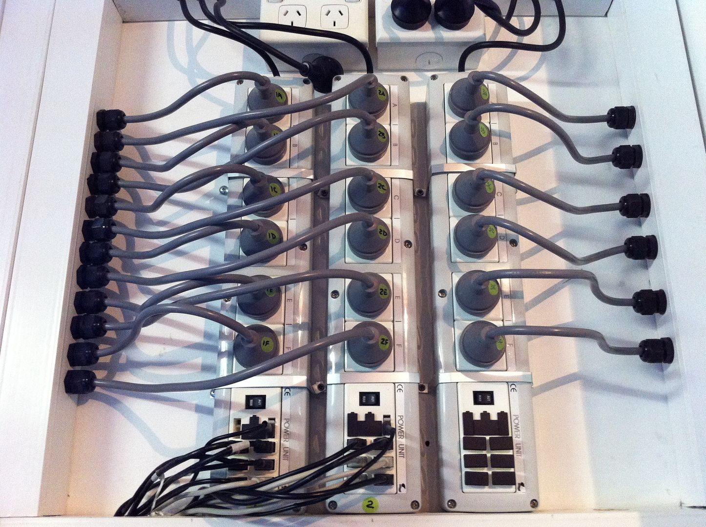

Can you explain what all the switches are for and how you know what is what please?
Re: ITS ME OR THE TANK !!!! 8 x 2.6. X 2 reef
Postby Amphibian » Mon 14 Oct, 2013 9:45 pm
Thommo01 wrote:Can you explain what all the switches are for and how you know what is what please?
What i have done there is ....
Each GPO ( power point) runs through its own RCD (residual-current device) and the active goes through the rocker switch.
I have 18 GPO that i have running thru the aquatronica controlled socket outlet .these are also controlled thru the same process,there is a few technical things i did to make it work, but i think you get the idea.
The reason for this is simple, if i have a failure of the equipment plugged in to the socket , it will shut down that circuit only.
This will allow the rest of the equipment to operate as it should.
Most power points run on one or two circuits in standard installs
I have run a new supply line just for my fish tank room (converted garage )
I have a total of 36 power points and 3 distribution boards .( Need more GPOs !! )
At the moment i have temporary numbers on the 36 switches and a legend for all the numbers.
The switches also allow me full control of the entire system. I can switch off any equipment in a event of urgency or service work.
I hope i have explained that well enough to understand.
When the circuit has been tripped an alarm is triggered and it will notify me via email to my mobile.
The email function has not been implemented as yet, still working to intergrade it with aquatronica .
I had it set up originally with sms but decided email would be better , and i can view the system in real time through IP cameras with pan function .
thats the short version LOL

Thanks, you'll be pleased to know that it does make sense.
Great idea actually. Extra benefit of being able to place your equipment in the best location and not have to worry about cable lengths etc.
